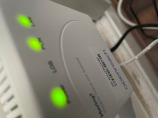

An Orange light means you have no network connection, depending on the version of ONT you have there may be an  LOS LED on the front and it should be 100% rock steady Off, does it flicker at all?
You should also have a PON LED, that should be 100% rock steady green, is it?

Hello no flickering apart from lan now and again at moment it’s not power is solid green Pon solid green an lab solid green
