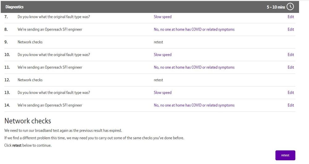

I used to have a phone number but like many people gave up the landline due to spam calls asking if I have had an car accident. I still have broadband though so there is a physical line there.
Due to a recent problem with slow speeds (2 rather than 28) I've tried to get an automatic test but the system doesn't recognise the old landline number and the BT account doesn't show a number either.
The next option was to try the online tests which confirms the slow speed, offers and engineer visit and then doesn't allow the option to book one. It just goes round in a loop which must have been funny for the software engineers that designed the form but not funny when you want a problem solved.
I have a brick wall ready to hit my head against but before doing that any suggestions?
