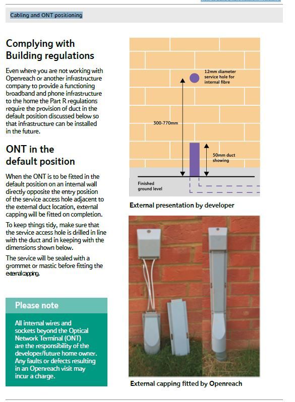

Installation day is this Friday & as I previously posted the hole which I drilled didn't need to go at an angle, it went straight through & into the capping just below the existing junction box so the new CSP box can be mounted with one of the knockouts level with the lead-in hole which makes it fully compliant with the relevant Building Regs, part of which state that The Fibre going into the house should not be visible, as its through a hole directly behind the CPE junction box
