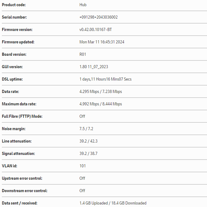

Hello,
I think I'm posting this in the right forum!
In February we had a fault on on line (a big branch had fallen and in the wind it was rubbing the line eventually causing the connection to drop in any gusts of wind) This was repaired about 6 weeks later. Since then my line has been stuck on slow speeds. I can't remember exactly what I used to get but I'm sure it was more than 25mb, now I'm getting 4mb if I'm lucky.
I had tried the old router a few weeks ago but got the same speeds and the fault is still showing as open. I've tried speaking to someone but I always run out of time on hold.
Is my line limited now, and is there a way to get DLM manually reset? I know its automatic but nothing has changed in the last few weeks. The line doesn't drop now.
Technical log:
Firmware version:v0.42.00.10167-BT
Firmware updated:Mon Mar 11 16:45:31 2024
Board version:R01
GUI version:1.80 11_07_2023
DSL uptime:10 days,16 Hours46 Mins51 Secs
Data rate:4.294 Mbps / 5.199 Mbps
Maximum data rate:5.291 Mbps / 8.541 Mbps
Full Fibre (FTTP) Mode:Off
Noise margin:7.3 / 9.4
Line attenuation:39.0 / 42.0
Signal attenuation:39.0 / 38.1
VLAN id:101
Upstream error control:Off
Downstream error control:Off
I appreciate any help or advice, even if it is just a case of waiting another couple of months for the automatic process to catch up, but ideally if there was something that could boost speeds a wee bit sooner rather than later that would be awesome!
Cheers,

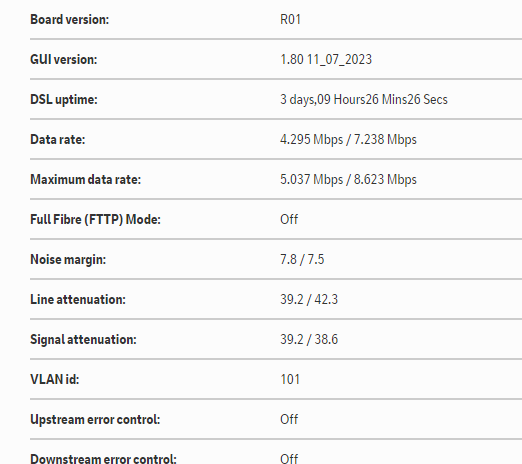

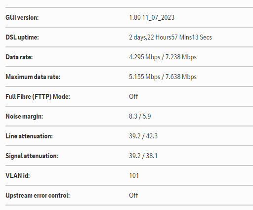

Still not much movement....Screenshot 2024-06-29 093353.pngScreenshot 2024-06-28 230511.pngScreenshot 2024-06-27 112324.png
3,686 Views
Message 5 of 10
Re: DLM stuck?
from the stats you have posted I don't think this is stuck DLM but it looks like your up speed is set on FTTC but your down speed is set on ADSL hence the 8mb max speed  the dslchecker gives estimated speed 32/22mb

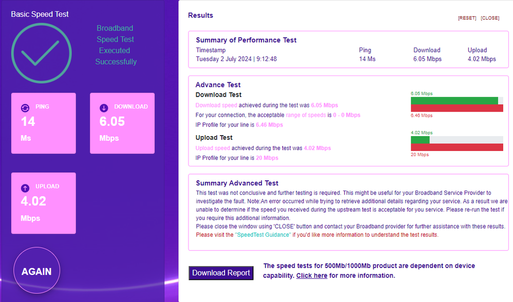

So according to yesterday's tech support chat, this will be different by the end of the day, fingers crossed!Screenshot 2024-07-02 091327.png

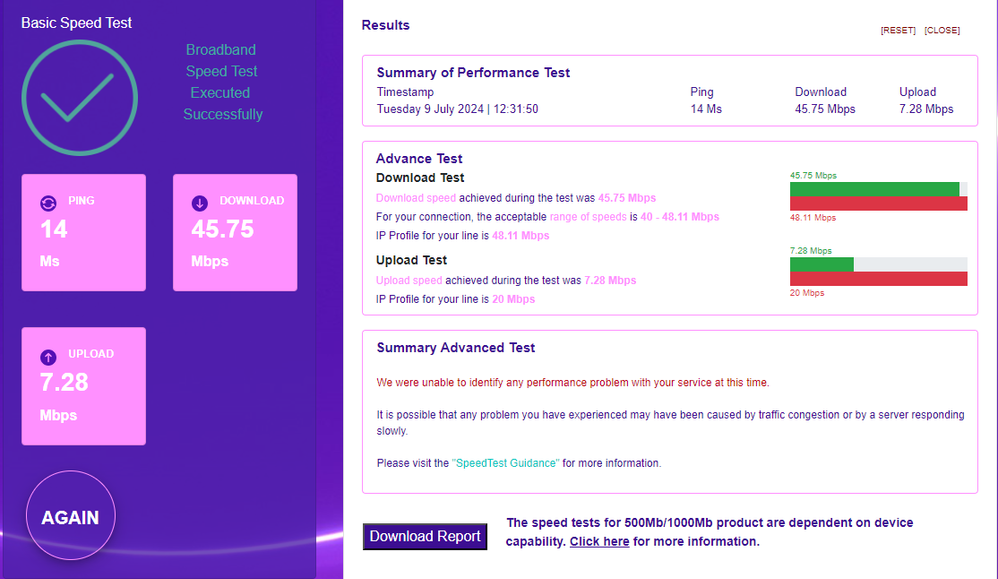

Screenshot 2024-07-09 123229.pngAll back up and running like never before. The engineer found a couple of faults in the line leading up the road. possibly masked by the broken line before but once he sorted the water filled junction and something else its running like never before. Took him a couple of hours in torrential downpours, great service!
Thank you for helping
