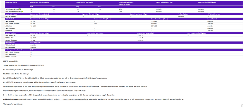

If you run this checker an post the results it will show what your line can deliver.
 BT Broadband (btwholesale.com)
If you do not have a phone or have a digital voice phone use the address checker.

And here's the info I got from the address checker:
6,910 Views
Message 4 of 8
Re: Download speed
Go to solution
Looks like your line can only support 40 Meg, however your hub only showing the connection for one day. Have you rebooted the hub? If you keep rebooting the hub trying do increase the speed the DLM sees this as a fault and slows the line. Do you know how far you are from the Green street cabinet.

According to your hub's stats you would appear to be getting about 30Mbps with the max data rate being about 36Mbps which is within the range that the wholesale checker indicates you should be getting albeit it is at the lower end.
While you have said that you are only a short distance from the cabinet, not all lines go by the most direct route to the property. Your line attenuation indicates the line is about 1.5km from the cabinet to your property. Your noise margin is 6 which is what it should be give or take. If there was a fault and DLM was reducing your line speed the reading would not be 6.
