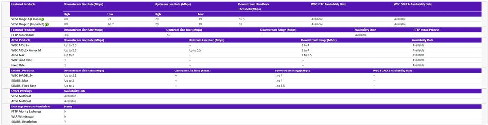

Thanks, I hadn't seen that.
That's what I see.
This is what I see.This is what I see.

You are on VDSL, so you should have no issues with any VDSL capable combined modem/router.

But at least now I know its VDSL.
