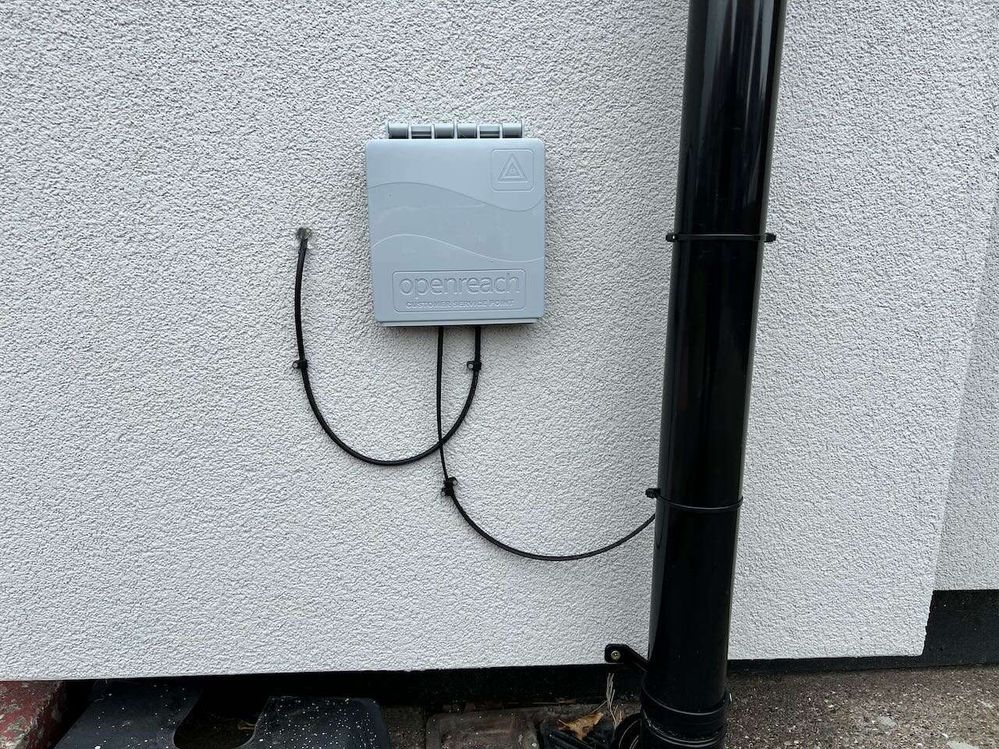

Just a quick update:
I had the install done.
Came out today (contractor) and said they didn't need to use the pipe i'd bought and they would just cable tie the fibre cable to the drainpipe. Looking at it after it looks ok but I'd have stuck a few more ties on as there is loose cable between the ties they used. I can imagine in the winds the loose cable will be flapping about like mad against the pipes.
Arranged for a cherry picker hoist van to come to do the height work as couldn't use ladders due to the EWI.
The cables gong into the outside box are a bit messier than I wanted. Attached with cable clips that will fall out very soon due to only 1mm of render on the EWI. I'll attach a picture if anyone has any suggestions on any tidying up solutions as they sticks out like a sore thumb again the render.
The old telephone line from the telegraph pole wasn't removed so I now have two cables coming to the house from the pole.
Speeds are as expected, I had to set up the phones which was easy enough to do. Can't seem to find the call guardian feature on them which we had on out old phones and was told was on the new phones they sent.
Here's that photo:
