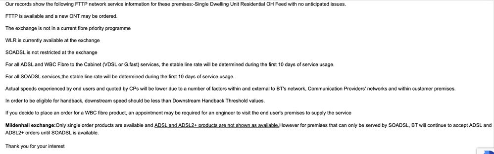

Can you post the paragraphs under the table please as that will say how the full fibre drop cable will reach your property

@Nick07
Looks like it will be fed overhead from the CBT from allocated pole to property

Thanks @jac_95
Does anyone have suggestions with OH? Into upstairs room?

The fibre cable from the pole will normally follow the existing copper cable probably to eaves and then it will come down to ground level where openreach will fit the CSP which is where the external fibre cable is joined to the internal fibre then drill hole to let fibre cable into home and then connect the ONT (fibre modem) which then connects to SH2
