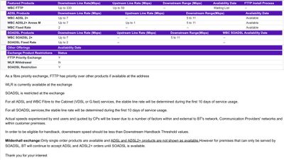

The broadband checker for my address says as follows:
Is it likely that the openreach engineer will be able to pull the fibre cable through the same duct the copper cable is in to my hallway? Or even complete any sort of installation? Apologies for the lack of knowledge or if the question has been asked a million times before!

are you sure you are getting FTTP as the dslchecker shows waiting list for FTTP  you also have an old ECI unit so speed restricted to 300mb
if you get FTTP then fibre cable would normally follow the existing copper provided room in duct and not blocked
