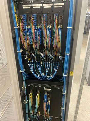

This is an Adtran Head End, there’s also ECI, Huawei and Nokia ones that look slightly different but they work on the same principle.
Each of those Coloured Cables as the top with the Blue Connectors is an Individual Fibre that make up a Hydra Cable and each one is Plugged into a Port that Provides Service to one PON, aka up to 32 customers, although Openreach only use 30 on each PON.
If your PON is supposed to be on say Port 2 but someone put it on Port 12 by mistake then it’s literally a case of unplugging the Hydra from Port 12 and Plugging it into Port 2.
Or it could be the Spine Fibre is on the right Head End Port and it may be your CBT is on the wrong SASA. In which case of would just need someone to splice it onto the correct SASA at the Splitter.
Obviously you just need a competent Engineer to Fault it correctly to prove exactly which one it is and fix it accordingly.
