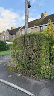

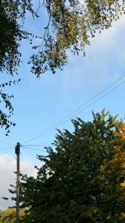

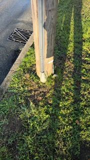

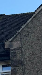

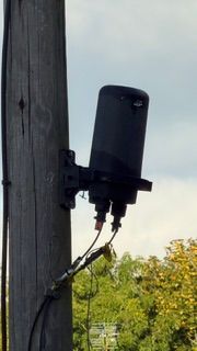

here are some photos
showing the first duct out side my house, at the bottom of the pole, where they pulled fibre through (you may have to zoom in as the BT duct is slightly hidden in the bushes. I am aware the smaller, more visible one is water!)
the pole and splitter outside my house
the neighbours pole. at this point, I must confess that it does appear that the fibre has may have been run overhead between these two poles, although clearly something is being pulled from underground, which I though was the fibre from the first pole. Happy to be corrected on this
Copper and fibre to neighbours house
None of the houses on these two poles, that currently receive copper, are showing as able to receive any fttp except for No7
