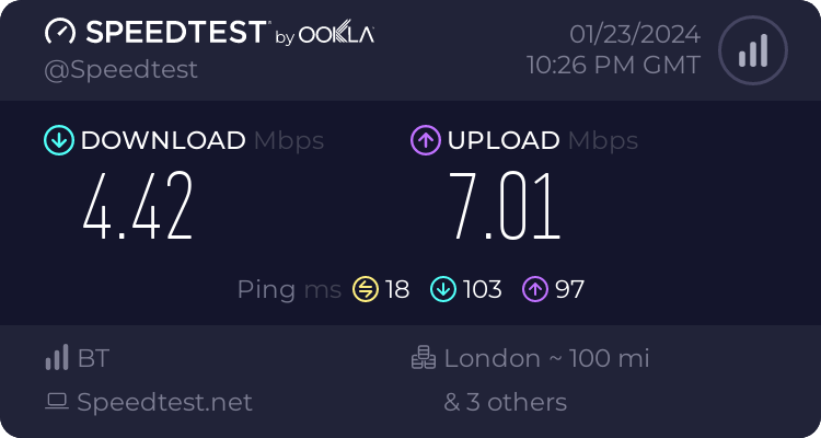

Got home tested, and we were getting 8Mbps down, 17Mpbs up
Left it a while, tested again, we were getting 32Mbps 16Mbps Up
Just testing again we're getting 4Mbps down 7Mbps up
Whilst I appreciate there's a "levelling out" period, I've never known it to fluctuate this much, we're on Fibre 2, minimum guaranteed speed for 55Mbps, this is far short of even the highest test I've completed.

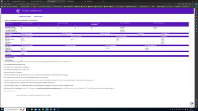

Message 10 of 19
Re: Fibre 2 (55 Mbps Min Guaranteed) - getting 4Mbps
So 80 mbps theoretically achievable?
Also noticed WBC FTTP under featured products, was lead to believe I couldn't get Full Fibre to this property... or am I reading it wrong?  Though, I'd settle a slight improvement on the 40mbps we're currently getting first...
