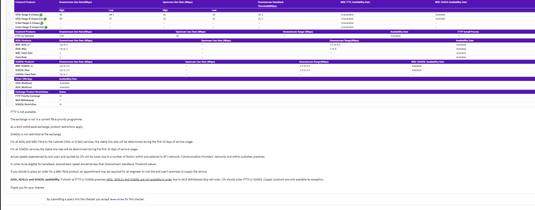

When we moved we created the home order to the new property, entered in the details of the new property and it confirmed 61-73mb Fibre 2 as per pic below, at no point was there any indication the line speed would downgrade by moving, otherwise I'd have bought this with BT at that time.

If you are on Fibre 2 package because your prediction was for 61-73 but your line can only actually support 43Mbps it sounds like your line is degraded / has a fault. What is on the predictor is only a prediction, and it looks like you are unlucky with your copper.
As has been mentioned the Stay Fast Guarantee is there for a reason, and from your screenshot it looks like yours is 56Mbps. If you cannot pursuade BT to investigate your line further then this guarantee is what you should invoke if you are not satisfied.
Bad news is that moving ISP won't help as they all use the same technology and the same piece of copper cable. Ultimately you need FTTP to improve your situation.
