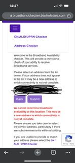

When checking BTs wholesale checker (https://www.broadbandchecker.btwholesale.com/#/ADSL/AddressHome) our flat says they can’t determine the status while the building itself seems to have good speeds available.

That is for the specific flat

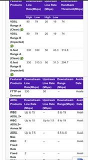

 This is for the building itself
5,369 Views
Message 5 of 14
Re: Flat doesn’t get fibre but building does
The building doesn't have FTTP either. FTTPoD is an extremely expensive business product, not native FTTP.
You should be able to get about 80M though unless the checker shows waiting list rather than available on the right hand side of the table that you have cut off in the screenshot

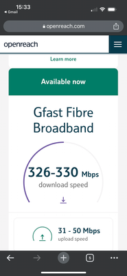

 On Openreach the building has this as well as other flats in the building but not mines
