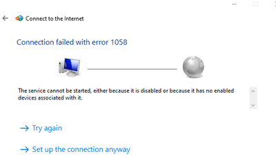

Thanks for your help. I couldn't get a connection and had the message below:

Try turning off the wifi on the laptop, it shouldn't do but it might be preventing the Ethernet connection working.
