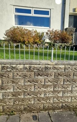

 The Toby box at the foot of my garden wall, fibre cable tied to black drainpipe , entered house under window, you can just see box behind bushes.

That doesn't make sense. Is there a CBT at the top of the pole you are fed from? Are you sure the Toby box is Openreach and not an Alt net box?

That isn’t an Openreach Toby Box, it’s CityFibres, possibly Virgin Media’s.

Apparently it was installed by virgin media in 2019 using openreach ducts.
5,337 Views
Message 8 of 13
Re: Full broadband installation
Go to solution
In which case it’s exclusively for Virgins use , no one else
5,334 Views
