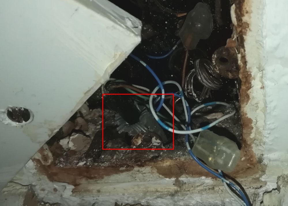

@iniltous  - what you've said looks to be the case.  I've removed an old fixed radiator cover that was blocking the phone socket.  This has uncovered the bodge job done by the previous occupants of the house to extend the phone cable to a different room.  Removing the socket has revealed what looks to me like armoured cable - see the red rectangle in the attached photo.
If a future FTTP installation involves a dig across the lawn, do they bury the optical cable in ducting/protection of some kind under the lawn?
When this type of installation is done, do they discuss with the homeowner whereabouts on the exterior of the house the dig/cable should terminate?  i.e. outside which room at the front of the house?
Thanks again.

Difficult to see from the photo, but it looks probable that it is an armoured cable. It should have 4 conductors, orange, white, green and black. Orange and white in use and green and black spare.
The fibre cable will be ducted to the house, not directly buried and location can be agreed within reason.
