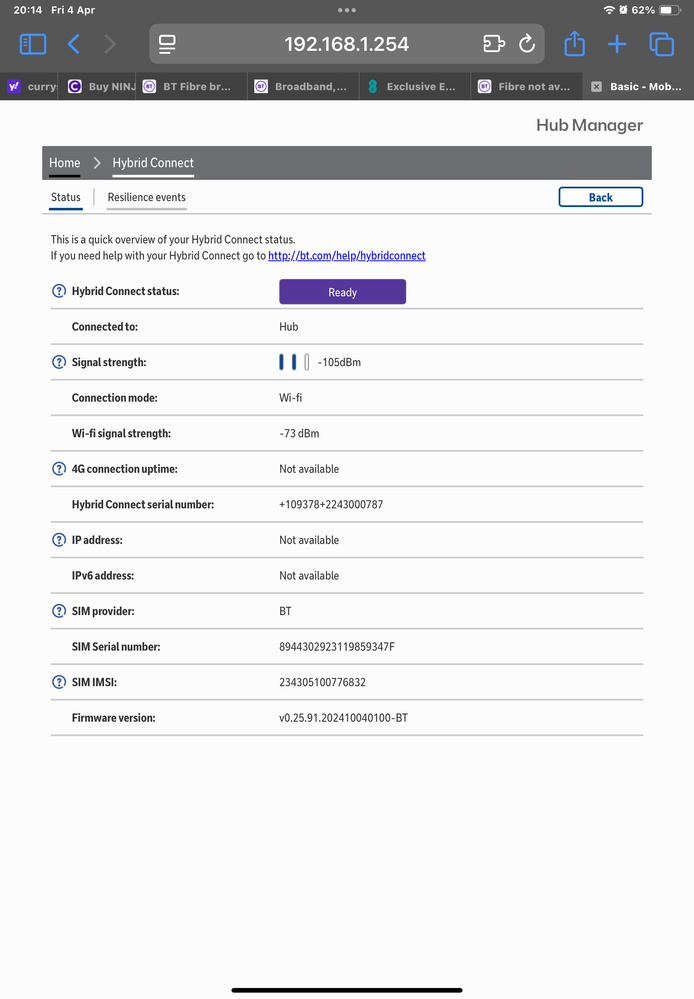

Hi,I have reset the hybrid connect but I have still got flashing red 4G lights. I went to the router settings and as can be seen it it shows two bars. Do you think this will work during a down time.I know I could try a test but would like to remove the flashing lights.

Hi, As you can see the router confirms 2bars and is ready it’s just that the bars on the front are flashing red as if there is something wrong. Any thoughts would be appreciated.
3,275 Views
Message 10 of 12
Re: Hybrid connect
Hi.  If the signal bars are red it means that there is an issue is with the device and you need to contact BT. I beleive that flashing red indicates a problem with the hub actually contacting BT via the mobile network, rather than connecting to the mast.  Tim
