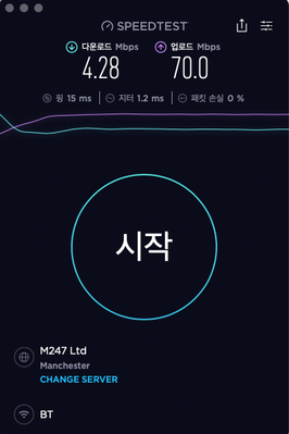

thank you for your reply
I am using hardwire CAT 5E(hub to the port on the wall) and 7E(computer to the port on the wall)
The speed is recorded just 4 Mbps download,,,
How can it be possible?
Please help me,,,

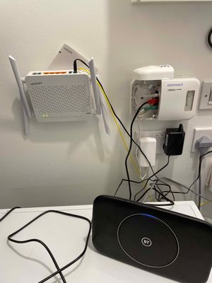

I tried to connect directly my computer to OpenReach.
The speed is around 50mbs, lower than the connection: Openreach-SB2 hub-computer(500Mbs).
I suppose the capacity of hub is not enough to support 900Mbps
I am very disappointed with the premium service.
I would appreciate if anyone could hopefully help me 😭😭please.
Also, I have no idea about the white one next to Openreach. It seems to be a modem. What is it for,,,? Could I solve the issue using the modem?
The engineer had tried to connect the modem but failed.
