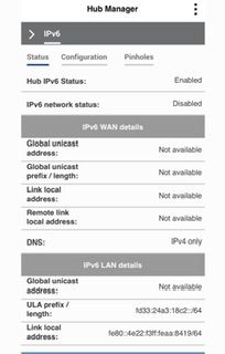

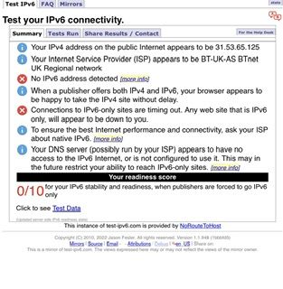

I have played around with those settings but to be honest IPv6 was available prior to my upgrade this morning. At the top of my screenshot it shows that it is disabled by the network not the router. I have been using that link, but unfortunately I am getting a score of 0/10. I previously got 10/10. I am having the same experience on all my devices too.
I have noticed that there have been others who have had the same experience, which appears to have been resolved by mods. I believe they are likely adjusting something on the network side, but I could be wrong. I will attach a screenshot showing my experience on the IPv6 test site below.

Yes, that does rather suggest that it's a network issue rather than anything you can change on your hub - I shall defer to the mods.

I am really pleased I could help you get this sorted.  As confirmed, out network team could see that the IPv6 wasn't built in the background.  They've sorted that now and reset your PPP session and I am really pleased you've got IPv6 connectivity now.
