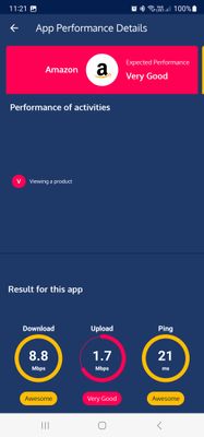

Yet,  30 mins later I've had
Ping - 21
Download - 8.8
Upload - 1.7
Service Quality Awesome
