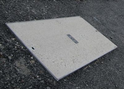

The openreach checker shows it is soft.
Also forgive for the silly question but what is a Toby box.
The nearest 'box' to my house is one of these probably about 50m away.
A few weeks ago Openreach installed cabling to this point. When I asked them, they said this serves all the houses in the estate and they are fed by ducting.

That’s a joint box lid not a toby box , the duct from here to the toby box should be new ( so scars in the footpath ) search for a Toby box image but they are normally a black plastic square about 4” , that the visible part on top of the new duct placed outside each address , occasionally a duct marker rather than a Toby box is used,  this is a 2inch round duct cover ( has OR printed on it ) ….there is always the possibility that the survey network note is plain wrong ,  or the area many have been designed to have toby boxes , but to save money initially on the build stage , they and the associated duct in the footpath were never provided, in which case a duct is provided from a jointbox ( like the one shown ) directly to the house wall when an order is received ( the correct SNN for that is ‘partial DIG’ ) , and that will confuse the installation people ( SD division, Service Delivery ) as they will expect less excavation than will be needed and they also will be scratching their heads wondering where the toby boxes are , either that , or they are there , you just haven’t noticed them …when was the property built approximately  ?
