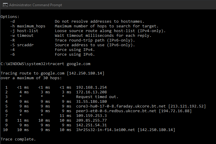

heres the tracert :
also gaming routers ive tried multiple to no avail . Before my line switched to BT interleaving was applied to my line as the vodaphone routers shows the interleaving depth . Switching from vodaphone to BT gaming connection wise feels the exact same . This is why im here trying to find out as you staff have access to find out . Im going off of experience what has worked for me . In the past the engineers used to SET my SNR at 6 for download and upload and have interleaving turned off  for both download and upload . I also asked about NGA / DLM profile . With the engineers its all been through trail and error these tweaks . Usually what happens is the engineer would tweak the settings then after 24 hours the DLM would kick in and tweak the settings undoing what the engineer had done . now before on a previous provider i had this tree that was rubbing / tapping on my line trimmed by an openreach engineer [ he rang a specific team to trim it ] and for 8 months i had no problems with the line and the DLM  didnt seem to alter anything . But that tree has grown back since then and ive had problems since , could the tree be causing the DLM to trigger ? ever engineer ive asked about the tree is saying its nothing to do with the tree  but then again engineers were telling me my lines fine since september last year when problems came again but only a few months ago corrosion was found on my line and dealt with .

Thank you for replying back and for running that tracert. I'm seeing no issues there and it all looks okay.
I can take a look at run a few checks if you like but in terms managing your expectation, there is always going to be some latency. Even the best connection would still see spikes of latency at times.
