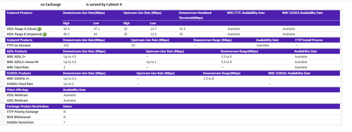

we currently are lucky enough to have FTTP, on talking to the builders its not something that I worried about as I was under the impression that FTTP would be a given for a new build nowadays.  But it seems that when they contacted BT they got quoted a really high figure for FTTP to be fitted this might have something to do wioth only building 9 houses on the plot.  The builder said they got told by them that we might get it installed for free as the area had been upgraded in the last year or 2. Now the postcode has become live it seems that we will not be able to get FTTP.  I have attached images of the BT broadband availability checker of my current street the first image.
The second image is for the house we are moving to, from what i can tell from this FTTP is available on demand if anyone can tell me what that means.

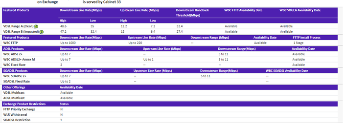

below this is a house using the same cabinet to be supplied but they can get FTTP?
This image is probably much more relevant this is the house from the development that was done around 10 years before on technically the same land our house is being built on.
Thanks for reading I am unsure what a lot of this table means anyone could help, please?
or if there is a way of paying for it?

FTTPod is a very expensive business product costing tens of thousands of pounds.

Openreach offer free FTTP on developments of 20 or more , 1-19 plots the developer is expected to pay something towards costs , so if they were not prepared to pay , it won’t be provided.
You could enquire about a community funded project, or FTTPod , although expensive, it’s relative, if it were £8k ( for arguments sake ) that may be a fraction of the cost of the property, if exploring FTTPod , you need an ISP that can arrange it , BT Consumer don’t offer this Openreach product, but in a nutshell, you ask an ISP that does FTTPod, they get a ballpark figure from Openreach, if you are tempted, you pay a non refundable deposit to get the actual figure , still want to proceed, you pay the ISP, and OR build network to your address
