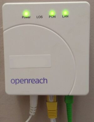

Have a look at this Openreach video:
https://youtu.be/3XDl0-KkPy8
The indoor ONT, the box that converts light into electrical signals that routers such as the BT Smart Hub 2 can understand, will look something like this:
