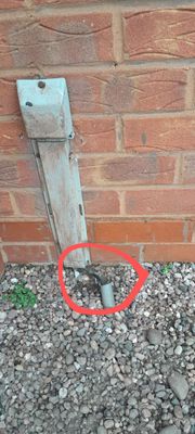

Screenshot showing external work complete which it isn't

So I have checked with BT as to why the order  online is showing  that the external works are complete. They say they have checked with Openreach and they confirm they are complete, which is a complete mystery as there are no other visible cables other than the original copper cable and no CSP see photo.
As it stands an engineer is coming out to complete the install on the 3rd March i.e. the internal installation which is going to be interesting given there isn't a Fibre cable to connect too. 🤔
