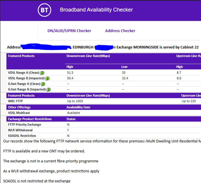

There's been a development. I think you have solved my problem! I think I may actually be able to get broadband but for some reason, all the providers are not using the address on the BT thing.

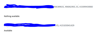

On the BT checker my address is listed in two different ways. The first one gets the red text, the second one gets this...
There is no difference between how the addresses are listed in the BT list, but after the addresses there is different information...
What I don't know how, is how to get through to someone who will listen to me that there is something amiss with all the providers' drop downs. This is something from a Kafka novel...

I've managed to get a deal to show on BT 🙂 They are the only provider that I can find that list my address twice. But that'll do. It shows it can be done. I've also filled in the form and pointed out the mistake. On Open Reach itself, both listings for my address are right next to each other.

There are various ways property in the UK can be identified, some are more common than others , most consumers would simply use their postcode to identify themselves for package delivery , getting utilities connected etc, hence the Royal Mail entry is considered the one to use , ISP’s etc may use more than just the postcode , and a network operator like Openreach ,(  even though the address checker is BTw product ) has various ways to enter data , if sufficiently interested you could look up your UPRN ( unique property reference number )  , a 12 digit numeric identifier, plenty of resources that can provide you with your UPRN , you can then use that instead of the postcode to see if that entry returns a result, that appears to be one of the differences between your address entry that worked and the address entry that didn’t return a match , but as you have now got a positive outcome , it’s obviously not necessary.
