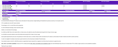

Here are the results from our cabinet:

FTTP doesn't come via the cabinet.  It might be he meant there were no spare ports on the CBT.
As far as copper goes, there may be a stop sell on copper at the exchange, in which case they won't be allowed to put a copper connection in.
Edit:  Right, I can see the image now.  So when he said 'cabinet' he must have been referring to copper/FTTC.  I think there has been a national stop sell on PSTN since Jan 23 but you may still be able to get broadband on FTTC if there was space in the cabinet.
