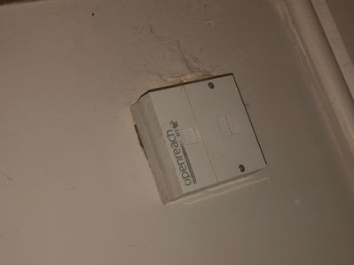

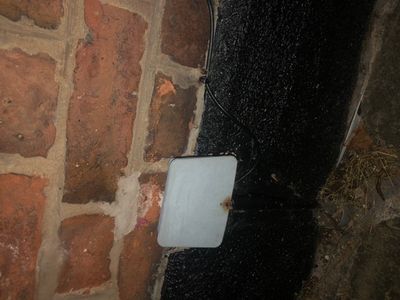

Hi thank you for the reply. Sorry I do not know the answer to either of the questions. I have attached pictures of the equipment I can see.

Does this mean if I am to go with BT I will need the fibre box installed on the inside of the property? And since my landlord refuses I must go with a different provider?

@Bilbo48
Your results from the BT Wholesale checker has confirmed it. You are on a exchange with a copper based product stop sell.
All providers will only be able to offer you a full fibre based product.
Recommend telling your landlord that they need to understand that only full fibre products are available. See https://www.openreach.com/fibre-broadband/retiring-the-copper-network
