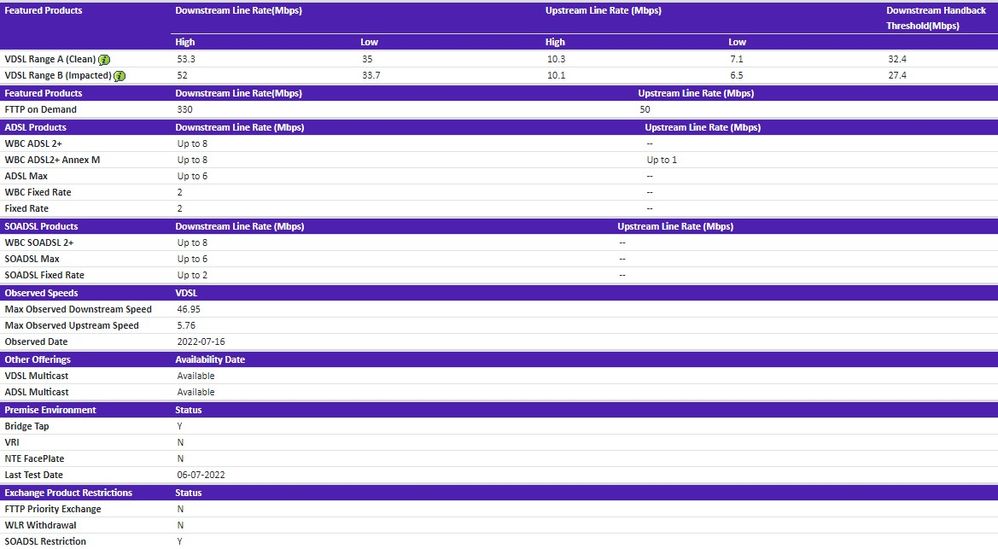

My broadband speed has been dropping drastically lately and I am having latency problems. I suspect it's my extension phone that is causing problems. I'll need to phone BT to cut it off and get a new faceplate so I can have my phone next to my BT smarthub and get rid of these dangly ADSL filters.
I ran a test on btwholesale and from what I can tell there does seem to be a fault with the line. I would like a second opinion before I phone up tomorrow.

from the dslchecker results your speed range is 53/35mb and also from results your connection speed on 16/7 was 46.95mb which is about halfway so does not look like there are connection problems
if you have landline and not digital voice then try phoning 17070 option 2  should be silent and best with corded phone
can you post hub stats from hub manager/advanced settings/technical log/information

your actual speed is just below attainable and your noise margin at 2.9db is giving a speed boost probably G.INP so you are getting as fast as your line can handle and well within estimated range

this has been covered often on forum  the speeds quoted by BT are connection speeds to your hub.  download/upload speeds are lower than connection speeds due to 'overheads' and is normal for all connections
your connection and download speeds look ok

as your top estimate is 53mb and currently getting 47mb then I doubt you are going to make any improvement
