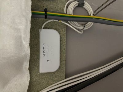

The building recently got cabled by Openreach as well, and in the cupboard outside the flat there is the Openreach junction box, so I believe that’s not a problem. It’s quite weird though that they placed the Hyperoptic socket in the cupboard, where there is no electricity. I wonder if this flat ever had the Hyperoptic broadband connected.

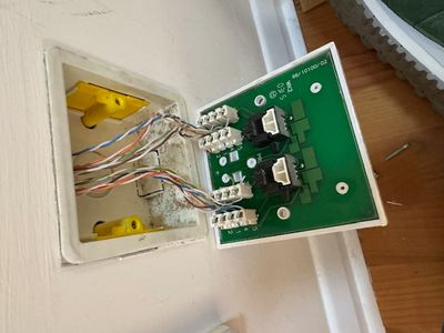

I just opened one of the numbered phone sockets and this is what they look like, do you reckon those cables would support electricity through them, or would it need a normal CAT5e cable fitted?

I wish I was an electrician, fitting a power outlet is indeed a very easy job, it’s finding an electrician that’s difficult!
