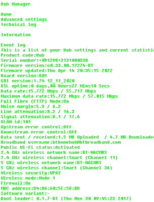

The brief stats posted suggest you have an FTTC connection and therefore the FTTP option in the hub stats should be set to  OFF and not ON.
Connection time is very low is that due to hub dropping connection or manual reset?

Sorry couldn't find colour swap.
Delay due to lack of connection - it crashed for the 3rd time (at least) today
3,647 Views
Message 13 of 27
Re: BT Broadband Speed below Minimum Guaranteed
I changed FTTP to FTTC; that was the last router restart which was after my last report
