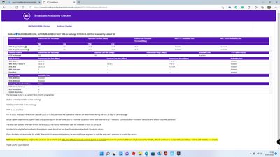

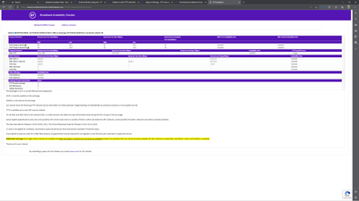

The only thing I can see different on the system is that my address doesn't show that it has ducting installed like the others.  It does and is the correct size etc as that's how my address is serviced currently.  I suppose if OR don't think we have it that could explain why we were missed out ??  and the high cost of connection.
Here's some information if you can see anything that might be useful.
 One of my neighbours details
