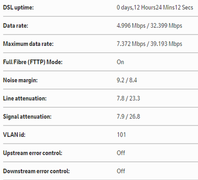

As the subject suggests our internet has been in the absolute gutter since about 2 weeks ago and I'd like an outside opinion on if it is likely to be the lines, obviously not gonna get much of a result until having them physically looked at, but I'd like a form of confidence..
We've already had an engineer to check out our hardware and has noticed that for some reason out internet isn't giving out the full speed that we've had before, specifically upload I talk of.. Being in the realms of on average being 6.5-6.9~ mbps but since it's been CONSISTENTLY, *Note not even fluctuating even a little bit which I've seen before* from 4.996mbps and the same goes for download, not moving from 32.399mbps
Even going as far as even had our router replaced to find that these data rates have NOT nudged from 4.996/32.399 and I'm ever so curious if anyone has ever had an experience similar to this before.. It's from Monday I'll be having this looked at but to say the least haven't much confidence

Your line has been banded by DLM due to instability, you need an engineer to investigate the line fault.

Yep, securely fitted, I've come to the conclusion that this is very well some kind of banding due to a DLM limitation because it somewhat lines up to the idea of it being caused from some instability because I recall the exact moment that we had these issues and it was around the time things became oddly patchy with our router, which is why we've been troubleshooting in the first place and got it replaced and the symptoms are exactly the same, for now I'll have to call to get the lines checked

Final update: Engineer's been and everything is all running smoothly again we've got our speeds back to what they are normally, apparently the instability was because the lines between the cabinet and our house had been damp in some capacity, happy customers!, thank you all for the need to know~
