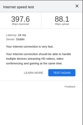

A little bit more research.
WiFi connected to the Smart Hub I am getting 400-450MBPS which is excellent.
Wired to my Pixel Book I am getting 90MBPS which makes me think the USB-C dongle is 100MBPS rated.
It looks like I am getting the BT900 service.  I'll just have to experiment with how I maximise distribution of the service around the house.  The Poerline adaptors have been excellent over the years but perhaps they are due for replacement or upgrade.  The house is an awkward shape with the service coming in at the least effective corner of the house - house built circa 2000.

WiFi test connected to the Smart Hub and one stud partition in the way, 15 feet away.
It's this complete lack of consistency which is confusing.
LAN adaptor - do you mean within my laptop?
I run a Pixel Book not a Windows machine.
that WIFI speed test is exactly what I would expect one stud wall away, in fact its better than I'd hope for.
Okay, I assume you are using an adapter for the Pixel Book for wired ethernet? In which case the adapter is likely to be limited to 100up/down so not a great test. You can probably confirm the link speed another way.
EDIT: So you confirmed my thoughts in a further post.
If you want 900Mbps WIFI in every room or close to you are going to need to spend alot of money and time configuring the network and radios. I wanted this for when I moved to 900Mbps and if you look at my sig you will see how many AP's I have to achieve this....
Power lines are fine for very basic tasks but you'll be lucky to ever get over 100Mbps from one.
