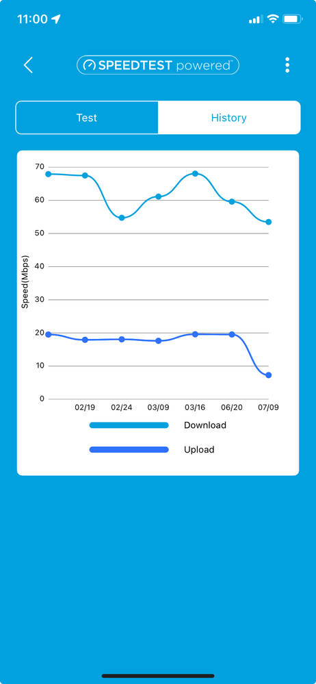

I am a returning customer to BT - coming back from Sky. I use my own modem and router - have done with both BT and SKY fibre products in the past.
Whilst at SKY I was achieving consistently a download speed of 60-70mbs and upload of 20mbs.
Having now switched back to BT Fibre 2, which states average speeds of;
  • Download speed - 67 mbs
  • Upload speed - 19mbs
Why am I now only achieving speeds of 50mbs and <10mbs?
The only difference here is ISP - all equipment and cabling is the same - this leads me to assume that I am being capped in some way?
Here are historic graphs from my ORBI router showing the drop in speeds since returning to BT.

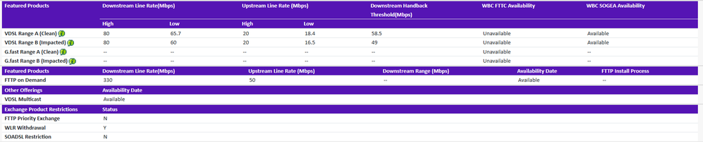

assuming you did only ordered broadband only package can you enter your address and post results to show what is available to you and hopefully confirm fibre 2 available
like @Anonymous  posted it does look like you have a fibre 1 profile

Hi, thanks for your reply.
Here are the results;
