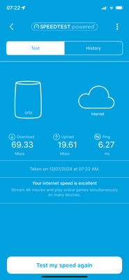

Thanks everyone for your help - here are my stats from this morning after mod intervention. Far more healthy.
