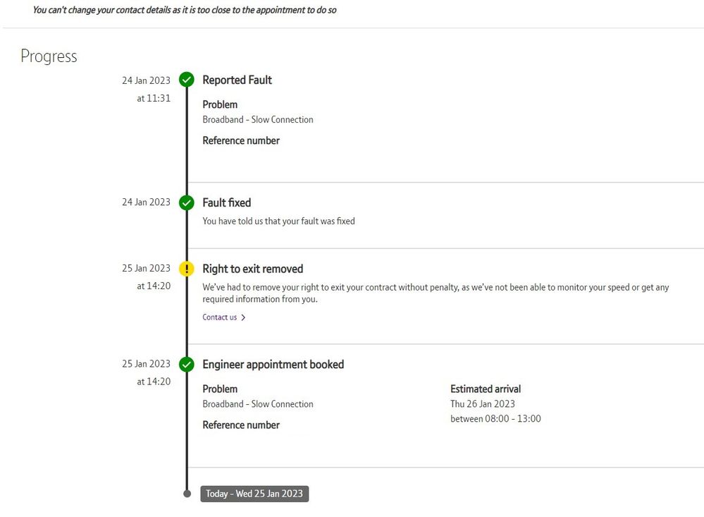

This is ridiculus, the system that its used obviously fails. Fault persistent and still existing. Problem fixed! How, where? Right to exit removed cuase cant monitor your BB speed...ofcourse you cant as I do not have service at all 😆 Very interesting this....All faults from the 10th closed as resolved but now Open Reach struggling to solve the issue and went up the 3rd line support and ADtran support even (ONT manufacturer)
Oh and BB - Slow connection no correct as its no connection at all 😆
