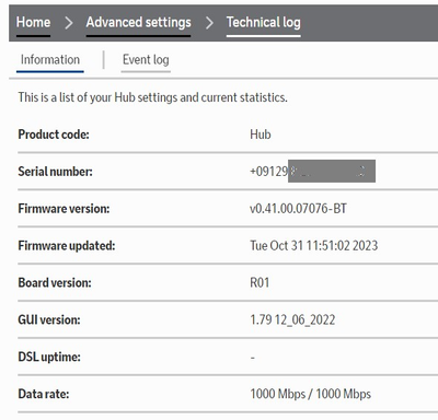

Hi All, My 900Mbs BT fibre install was completed 24 hours ago but the highest speed I've managed to achieve so far via one of the ethernet ports on my SH2 is around 500Mbs (although today I'm achieving only 200).
I'm a telecoms engineer (not FTTP though) so I'm pretty sure I'm not missing anything obvious. Laptop interface negotiates at 1Gps through a new 2m Cat6 cable to the hub. No VPN in use. No other users at the time of testing. Have tried a different laptop.
Weirdly, most of the times that I run the speed test from the My BT app, it tells me that the speed is in the 900 range.
Can anyone suggest a solution please?
Thanks

Hi - Just tried PPPOE direct to ONT and I only get 250Mbs

For anyone else reading this in the same position - After 24hrs there was no change but after 48hrs it'd sorted itself out and the speed went up to 970Mbs.
