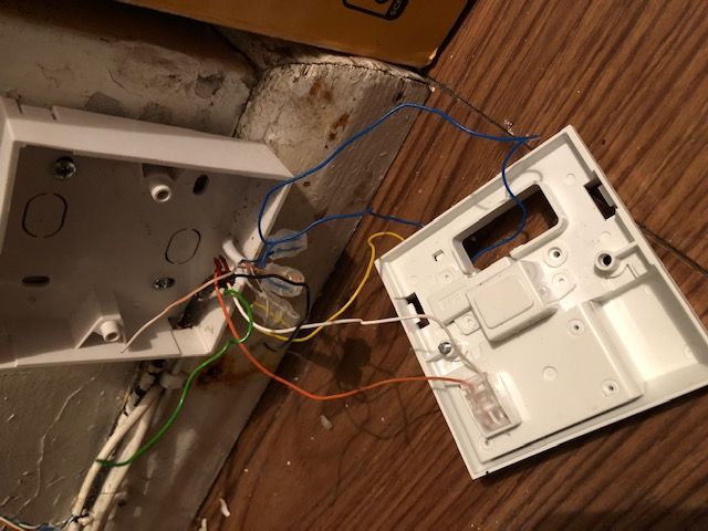

There is one phone socket.
Per the image, the cable closest to the wall is the line in, the next is the extension (then there's the random cable that goes nowhere).

Sorry - Just seen. Will check the back and try posting a larger image.

Is this a large enough image?

The line in is correctly wired. Extension should be wired to the clear socket on the frontplate as before but the wires should come through the slot rather than how they are routed in your picture.

As above, it's correct but a bit of a mess. You can just flip up the clear cover on the extension wiring & pull the wires out. They can then be fed through the cutout so that everything fits properly. Just make a note of what goes where first!
If she can live without the extensions I'd just remove that wiring completely.
Here's a video:
https://www.youtube.com/watch?v=jbfHMsP6IsE
If she does want the extensions I'd be inclined to move the back box to the left so you have slack to work with  can get rid of those clear crimped joints.
