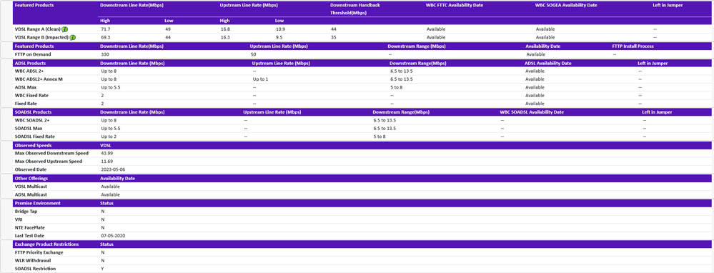

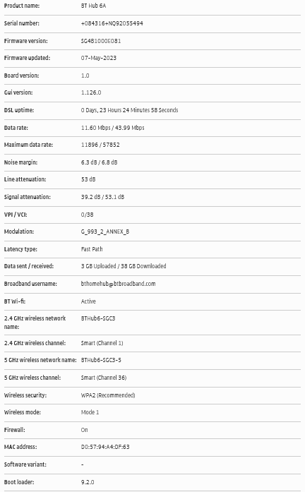

Hello,
Is there someone a bit more knowledgeable than customer service able to to explain to me how or why my line has become so poor in speeds. When I first opened the line many years ago I had a stable 68mbps for years then a line fault caused a drop in my speeds to 51 to 55mbps but they never recovered, I gave up chasing it and settled for what I had.
Recently I have encountered connection drop outs at home when running more than one device, on investigation my speeds are at 41mbps but after a tech visit with no issues found and no callback from customer service I am again at a loss on what to do to improve my speed.
Any help or advise would be greatly appreciated.

Your line has been banded by DLM due to instability. Until the line fault is fixed your speed will not improve. You need an engineer visit to investigate the fault.

I would suspect line issues being the culprit, although quiet the attenuation has increased a bit since my last post(not that I know very much about it).

The hub has just had a firmware update hence the short connection time
Did you try the quiet line test? It should be silent

After an Openreach visit today, a few tests, a little connection refresh at the cabinet and a cap removal the speeds have improved. On a plus note my ping has halved so I hope whatever the issue was It wont resurface.
Thanks for the helpful info.
