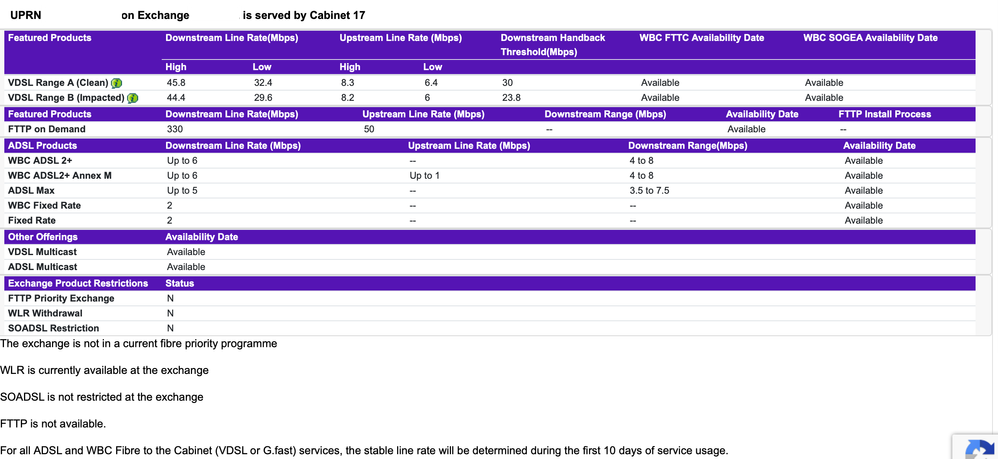

BT Wholesale Broadband Checker: We're about 300m from the nearest street cabinet down the road.
Hope all the above info is of use in working out what the issue is. Any other info you need, let me know. All help massively appreciated! Thanks!
