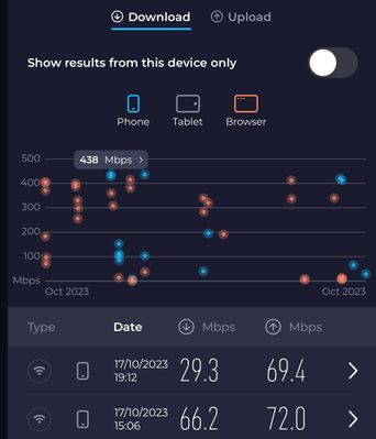

My speeds are barely functional at times over both ethernet and WiFi. I'm paying for a 500 Mbps service, but often getting a paultry 6-16 Mbps. My Ookla speed test log is a scattered mess. The most "demanding" devices on my network are the kids iPads.

My uploads are really stable on wired and Wi-Fi (see below)  bizarre this mystery problem is only impacting downloads.
