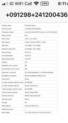

ive reset hub but no change, tech support not helpful. Hub stats say download speed 40mps and maximum is 59mps

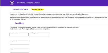

Your line may not support a faster speed.
Use the address checker on the page below, and post the results, but edit out your address details first, but leave the exchange name and cabinet number showing.
Please include all notes at the bottom.

Expected connection speed 43.1 to 59.6, so your hub speed is just slightly lower than this. It could take 10 days to increase, but you must not restart or disconnect the home hub, as that will be seen as a possible fault, and the connection speed would not increase.
What is the downstream noise margin showing, on the home hub stats?

Downstream noise margin is high at the moment, but this will reduce, and the connection speed will increase, once DLM (Dynamic Line Management) decides that the line is stable, with a low error rate.
For an explanation see https://community.plus.net/t5/Library/FTTC-DLM-What-it-is-How-it-works/ba-p/1322799
Do not let the helpdesk do any resets.
Owing to your distance from the cabinet, the upgrade is unlikely to make much difference to the actual download speed.

@rothwelljohn7
According to your hub stats it looks like you're still on the Fibre Essentials product. It's as though your regrading hasn't been applied.
