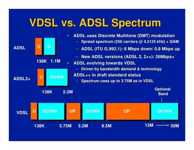

A loss of upstream connection speed can be caused by a deterioration in the high frequency response of the cable pair which would not be detected by the normal BT line test.
Its also possible that a faulty port in the cabinet could be causing this. This could be proven by Openreach checking the performance at the cabinet, with the local pair disconnected.
The picture below shows the frequency distribution of the broadband carriers, and you will see that a large proportion of the upload bandwidth is at the top end of the spectrum. (Look at the VDSL section)  Unfortunately that is the area that is affected most by any deterioration in the line quality. This can be cause by moisture ingress.
Assuming you have not made any changes to your internal wiring that may affect the frequency response, then you are possibly looking at a line or equipment fault.

Many thanks, Keith and imjolly - extremely informative. If a router rebuild / new router doesn’t solve my upload position I will be able to explain all this to the Faults man next week when he calls. He can then get someone to look in the cabinet …. (which is 600m away - not ideal).
