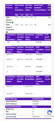

I've just done a BT speed checker for my phone line, which I've never done before. Please could someone help me out with it.
I just need to know what VDSL clear and VDSL impacted mean at the top and also which figures do I go for, which tell me my phone lines download and upload speeds?
I took the screenshot on my smartphone.
Thank you 😀

It just means that those are the speeds that can be expected for a line without or with  impairment such as a bridge tap etc.
You don't get a choice it is the characteristics of your line. The speed you actually get is predicted to be  between 55.9Mbps and 35Mbps but the actual figure will not be known until the service is provided.

The speeds shown are connection speed to your router not download speeds at any device.  The download speeds on wireless device will fluctuate due to interference a d best checked by ethernet connection. Expected connection speed at router would for vast majority of customers is the top line

@Anonymous the only thing I can think of that may prevent broadband being delivered down your current line is a thing called DACs where two properties share the same line. When moved to a fixed line broadband connection Openreach will remove the DACs as part of the process and you will have your own line.
As shown from the database results provided by Openreach and BT Wholesale for your property a broadband connection is indeed possible and can be ordered.

VDSL is FTTC ( fibre to the cabinet ) broadband and can deliver upto 80Mb speed, you obviously can get this service ( so much for your incompatible line ) , your predicted speed is shown , in very basic terms, others living closer the the FTTC equipment would get faster speed than you, those further away slower speed , it’s a rate adaptive system , the line rate varies , mainly with distance from the cabinet.
There is an ‘I’ button that define what a clean and impacted lines are, impacted lines may not be anything to do with Openreach, someone could have fitted ( badly ) their  own extension sockets which could   ‘impact’ the speed delivered , so the consumer is given a range of speeds,  indicating what they should expect , they won’t necessarily know if the line they have is clean or impacted. Its an estimate anyway ( and tends towards the pessimistic ) so in many cases the speed delivered can be better than the clean guide.
