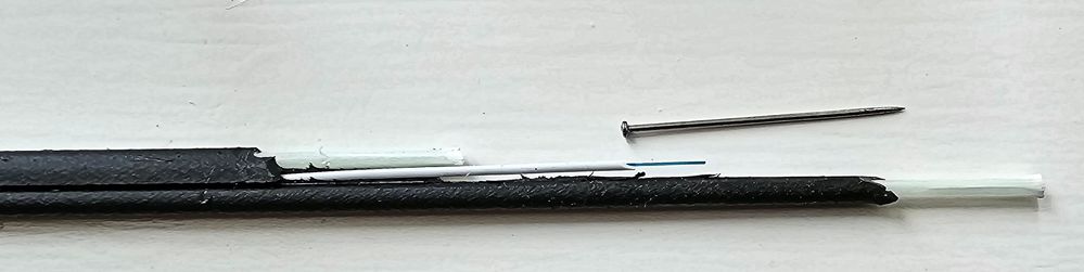

The fibre 'cable' from the street chamber to the CSP (grey box) has a mind of it's own and will snap very easily.  I have just tried a piece and the best radius I can get before snapping is about 70mm.  The cable has to be handled carefully as it only wants to be straight and you have to be mindful of the whiplash.
The actual optic strand is very fine as demonstrated above alongside a dress making pin but when the cable snaps, it is the two protective Glass fibre cores that run either side of the optic.
