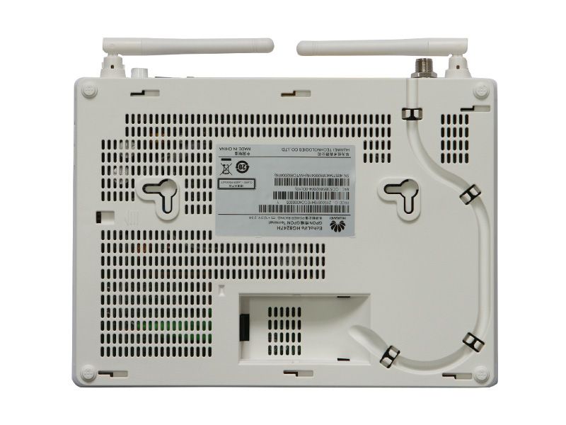

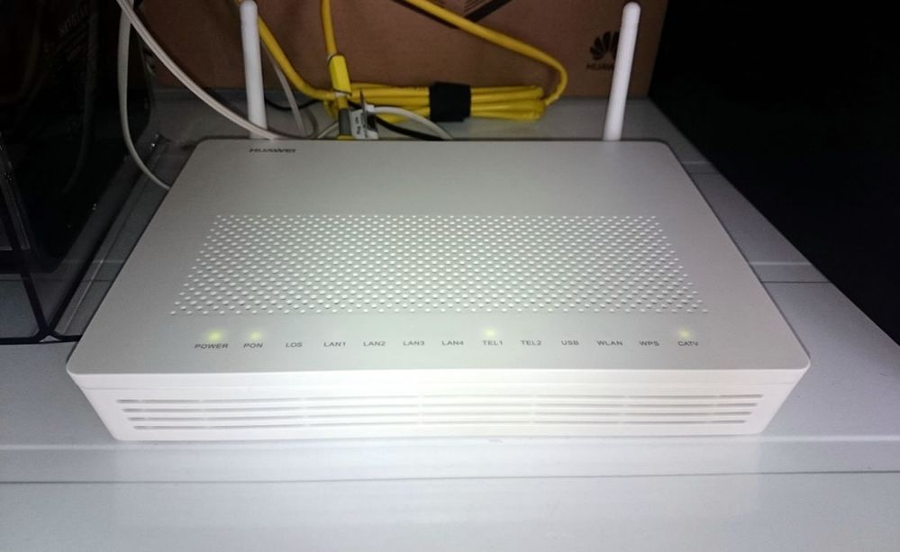

When I lived in Portugal with Vodafone, the fibre connector went straight to the built-in GPON Modem/Router.
Like this: rBVa4WASZ9KAIzctAAD8yCcqGss491.jpg
The fibre connector is located in the bottom of the router, so yeah its possible but again in Portugal Vodafone owned the fibre infrastructure, it wasn't shared.

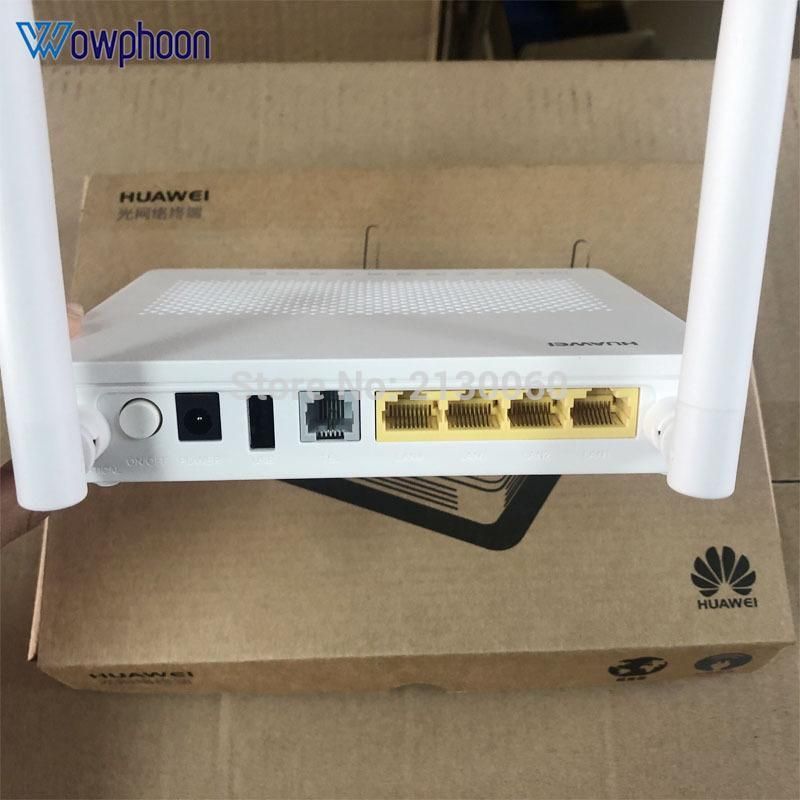

All I see on there is an RJ11 Port, which would imply it’s either an ADSL or VDSL Modem.
If it was a GPON ONT it should have an SC Fibre Connector Port.

It has one on the bottom of the unit, not shown in the picture.
This was the unit I had before.

Ah right, I see it now through the Air Vents.
Doubt BT and or Openreach will ever use those as they’re Huawei and they’re under pressure from the Government not to use them anymore because of Security Concerns.
BT Technology have already been instructed to remove all Huawei Equipment from the Backhaul Network and Openreach have stopped using Huawei Head Ends in favour of Nokia and Adtran.
