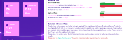

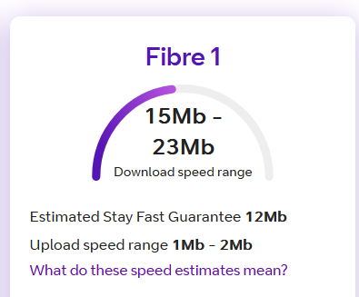

My Fiber1 has been playing up for the last couple of weeks...i used to get 20mbps (i know - its slow...i live 2 miles from the cabinet - and BT refuse to help me connect to the Cabinet that is 6m from my house thats apparently only for new builds but thats a whole other topic), but recently get around 10mbps  and tonight its about 2mbps!

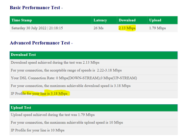

Running a test - seems my IP Profile is just 3mbps?
Can the Mods take a look please - as said, the service has been getting worse and worse for a few weeks, and turns off/on at least once per day
We used to get about 20mbps+.....

have dial tone but very crackly - rain getting inside line
2,225 Views
Message 5 of 6
Re: Wrong Ip Profile? Fibre1 running at 2mbps!
@northy1
Report a noisy phone line, as that is the cause of the slow broadband.
Once the phone line is fixed, the broadband will recover.

@northy1
An addition to @Keith_Beddoe's advice is to NOT mention broadband , just the noisy line.
