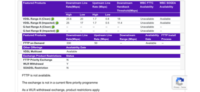

According to dslchecker results you best connection is 25mb down and 1.7mb up and probably actual is below that.  There is no fibre to the home available just fibre to cabinet and copper to your home

We had a bt engineer out today and he said we are right on the edge of the reach of the cabinet so he said it won’t ever be good

You can see your predicted speed,  17-25Mb , that puts your line length 1300-1700 metres from the cabinet, so your speed is not going to be great , that’s just physics , long line slow speed ( when  it comes to FTTC  ) …..the speed you get should be fine for VOD HD TV ( provided nothing much else using the bandwidth at the same time ) , 4K UHD is not really feasible, however you may not be getting the predicted speed if the line has an underlying problem….you need to post your router connection statistics to give an idea if you line is connecting around this predicted speed or is underperforming.
